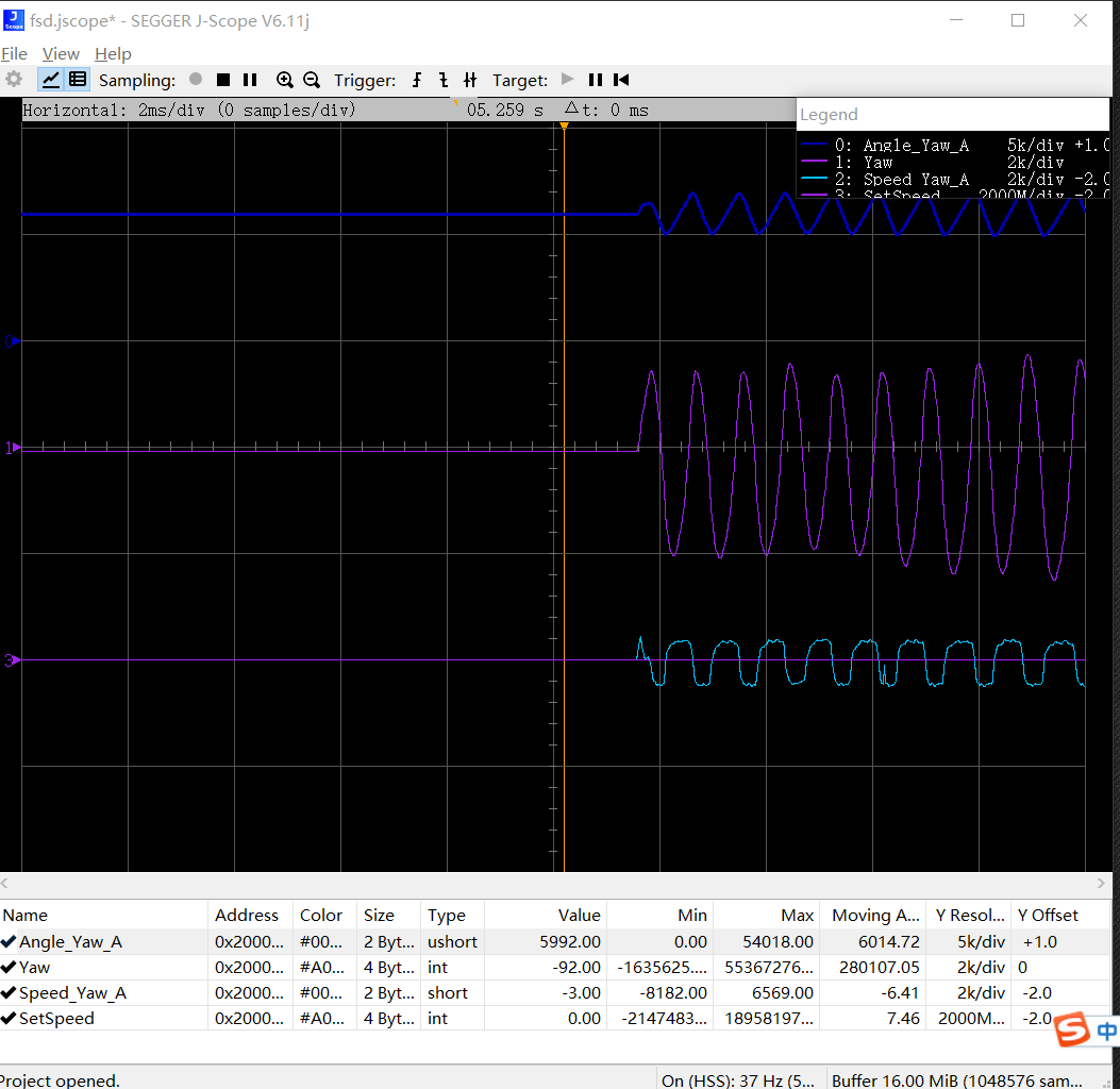

单独用位置环还可以, 弄个双环pid就废了,尤其速度环这块,始终调不出想要的效果,有没有哪位能够给点建议,比如mpu6050的数据需要怎么处理?P给大了等幅震荡,小了没力量.贴一段渣渣代码:

int PID_realize_Angle(pid_type *PID_x, int ActualSpeed)
float P_set=1.0,I_set=1.0;
PID_x->ctualSpeed = ActualSpeed;
PID_x->rr_next = PID_x->rr;
PID_x->rr = PID_x->etSpeed - PID_x->ctualSpeed;
PID_x->ntegral += PID_x->rr;
if(PID_x->rr > 800||PID_x->rr < -800)
P_set=1.8;
I_set=0;
else if(PID_x->rr > 400||PID_x->rr < -400)
P_set=1.5;
I_set=0.3;
else if(PID_x->rr > 100||PID_x->rr < -100)
P_set=1.2;
I_set=1;
else
P_set=0.5;
I_set=0.3;
PID_x->ntegral*=I_set=1;
PID_x->utSpeed = PID_x->p * PID_x->rr * P_set+
PID_x->i * PID_x->ntegral * I_set+
PID_x->d * (PID_x->rr - PID_x->rr_next);
return PID_x->utSpeed;
* @brief ËÙ¶È»·pidº¯Êý ²ÉÓÃÔöÁ¿Ê½Ëã·¨
* @param pid½á¹¹Ìå ËÙ¶Èʵ¼ÊÖµ
* @retval ·µ»ØpidÊä³ö Á¬½ÓµçÁ÷»·
* @note ²ÉÓÃÔöÁ¿Ê½Ëã·¨
int PID_realize_speed(pid_type *PID_x, int ActualSpeed)
PID_x->rr_last = PID_x->rr_next;
PID_x->utSpeed = PID_x->p * (PID_x->rr - PID_x->rr_next) +
PID_x->i * PID_x->rr +
PID_x->d * (PID_x->rr - 2*PID_x->rr_next + PID_x->rr_last);

Yaw += PID_realize_speed(&Yaw_PID_S, -Speed_Yaw_A);
Pitch += PID_realize_speed(&Pitch_PID_S, -Speed_Pitch_A);
if(Yaw>&&Yaw<400)
Can_buf_S[0] = ((Yaw+200))/256;Can_buf_S[1] = ((Yaw+200))%256;
if(Yaw<0&&Yaw>-400)
Can_buf_S[0] = ((Yaw-275))/256;Can_buf_S[1] = ((Yaw-275))%256;
// if(Yaw>)
// Yaw += 400;
// if(Yaw<0)
// Yaw += -400;
// if(Pitch>)
// Pitch += 400;
// if(Pitch<0)
// Pitch += -400;
// if(Yaw>000)
// Yaw = 5000;
// else if(Yaw<-5000)
// Yaw = -5000;
// if(Pitch>000)
// Pitch = 5000;
// else if(Pitch<-5000)
// Pitch = -5000;
// Can_buf_S[0] = Yaw/256;Can_buf_S[1] = Yaw%256;
Can_buf_S[2] = Pitch/256;Can_buf_S[3] = Pitch%256;
CAN1_Send_PZT_Msg(Can_buf_S,8);
// printf("Y:%d\t P:%d \t err:%d \t P:%f \tout:%d\n",Angle_Yaw_A,Angle_Pitch_A,Pitch_PID_A.err,Pitch_PID_A.Kp,Pitch);
TIM_ClearITPendingBit(TIM14,TIM_IT_Update); //Çå³ýÖжϱê־λ
* @brief pid³õʼ»¯º¯Êý
* @param pid½á¹¹Ìå P I DÈý¸ö²ÎÊý
* @retval ÎÞ
* @note None
void PID_Init(pid_type *PID_x, float p, float i, float d)
PID_x->etSpeed = 0;
PID_x->utSpeed = 0.0;
PID_x->ctualSpeed = 0;
PID_x->rr = 0;
PID_x->rr_last = 0;
PID_x->rr_next = 0;
PID_x->ntegral = 0;
PID_x->p = p;
PID_x->i = i;
PID_x->d = d;
// PID_x->max = max;
// PID_x->min = min;
* @brief ½Ç¶È»·pidº¯Êý ²ÉÓÃλÖÃʽËã·¨
* @retval ·µ»ØpidÊä³ö Á¬½ÓËÙ¶È»·
* @note ²ÉÓÃλÖÃʽËã·¨
P_set=1.8;
I_set=0;
P_set=1.5;
I_set=0.3;
P_set=1.2;
I_set=1;
else
P_set=0.5;
I_set=0.3;
【求助帖】请问大家的云台速度环是怎么调的?
